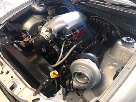

I had to build a upper intake manifold to this thing, og is way too restrictive.
I think something lke this:
https://www.proflowfab.com/cdn/shop/pro ... 1597392725
