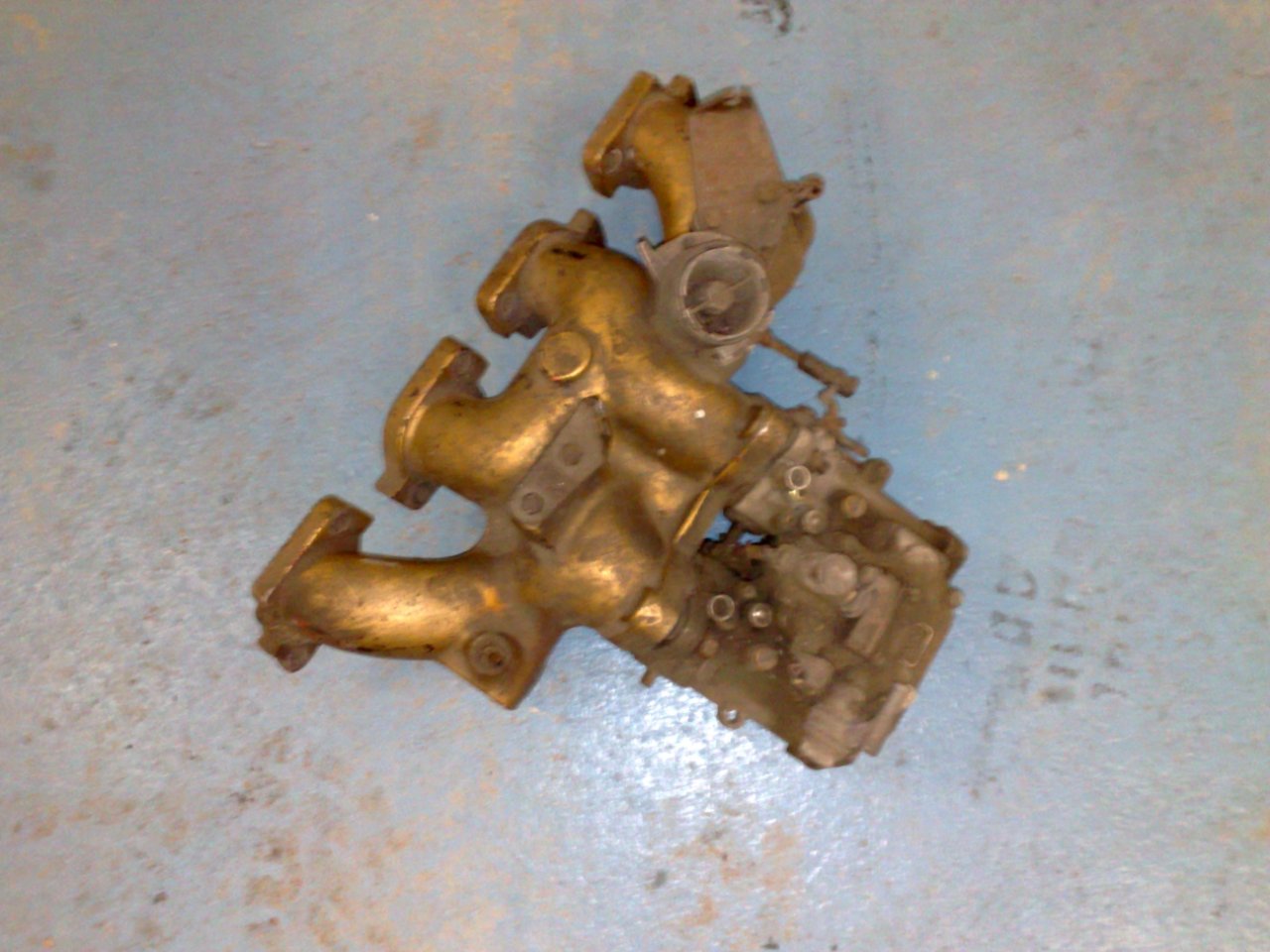

Baxman
Inlägg: 469
Blev medlem: ons dec 17, 2008 10:49 am
Ort: Norge
Re: b230 problems.
Inlägg av Baxman »
bmw2101
Inlägg: 153
Blev medlem: tis feb 16, 2021 9:33 pm
Re: b230 problems.
Inlägg av bmw2101 »
what is that manifold from? my mate here in the uk has one modded to take split 50;s but as far as i can see the 50 dcoe can only do 46mm choke size. So the zenith or the su is not far off that at all.
i can get a manifold made, or make one myself, i think itll open up the inlet restriction problem. The plan i have for the carbs, i cant really say, but they wont have flat spots etc, itll run " just like injection "

I have built and used different manifolds with 2 carb inlets, built from both K (no interconnecting plenum) and A manifold (interconnecting plenum), as well as the cast manifold for a single DCOE.
Less work to get the DCOE to run right as you can change the jets instead of modifying the needles in the SU type carbs, but those manifolds leave a little to desire otherwise, so a single plenum would probably be better. You'll might lose some possibilities for length of runners compared to F manifold, but gain some flow most likely.

I've never had any of them on a dyno to compare, but I my guess is that the twin SU is better if one doesn't mind the extra work. (or a single plenum with straighter runners and a single DCOE)

right i have just bought a set of twin stromberg 175 carbs, where can i get one of those aq140 inlet manifold s from please? I may end up making my own though if i cant get one.
thanks
psa
Inlägg: 319
Blev medlem: lör apr 21, 2012 9:21 pm
Re: b230 problems.
Inlägg av psa »
I'm not sure, maybe search the web for used ones, I think I've seen someone selling modified A manifold as well. But if you know someone that can weld aluminum and machine it for you it's done pretty quickly, the material is good to weld in as long as you clean it well.

Rewelded manifold for B230 and 2x carbs can be found here, klick on "delar"
