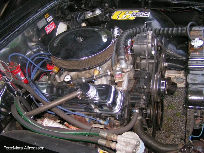

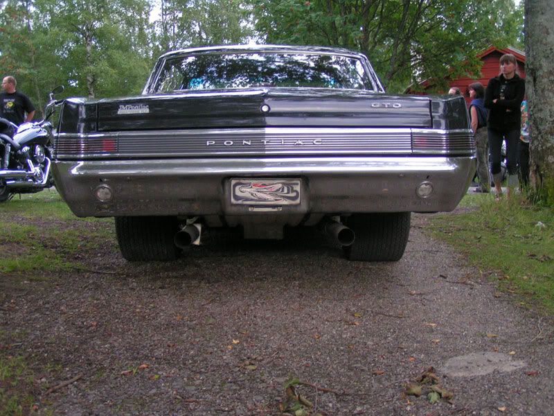

limpan skrev:är det en gatbil? om det är det hur går de att köra med alustakar?
Läste det här på Nitroz angående Alustakar på gatan
På gatan=forever:
"In a street application, using the aluminum rod is a no brainer," BME President, Bill Miller recently said in an interview with an automotive magazine. "I don't know exactly how the myth that aluminum rods can't be used on the street got started, but I'll guess that early manufacturers of aluminum rods, back in the 60s and early-70s, weren't making them using the forging process we're using. With the material we've got and they way we manufacture the connecting rods, they'll live a couple hundred thousand miles on the street because a street application is, for the most part, low load. You gotta understand, our basic Aluminum Rod is made for 10,000 rpm and 800-hp. The design criteria for the connecting rod is way overkill for what it's gonna see on the street. We been running aluminum rods on the street for 20 years."
Annars, kolla med BME:
http://www.bmeltd.com/rods.htm
Det verkar ju stämma rätt bra att man kan åka alustakar på gatan
Farbror Bill Miller bör ju veta
