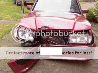

And after:
(Looks worse then it is)

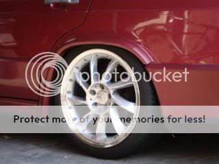

And with the new wheels

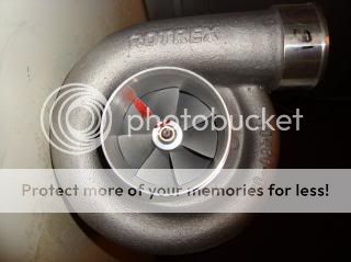

The rotrex c38-81 (450-650hp) with 70mm intake.

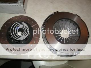

New SPEC clutch good for 850NM:

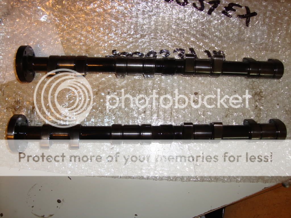

New catcams:
duration[0.1mm+cl] IN 282° EX 261°
duration[1.0mm+cl] IN 248° EX 224°
valve lift [cl=0] IN 11.50mm EX 10.15mm
peak angle IN 110° EX 120°
timing[1.0mm+cl] IN 14/54° EX 52/-8°
lift at TDC[cl=0] IN 2.95mm EX 0.75mm

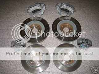

Brake's from a c55 AMG
345mm with 4 potter in the front and 300mm 2 potter in the rear:

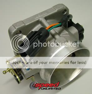

70mm throttle body from a mustang:

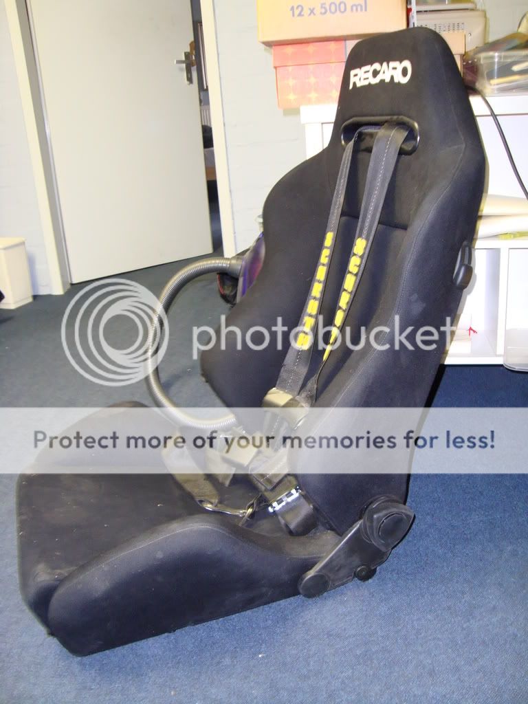

2x recaro speed seat incl belts:

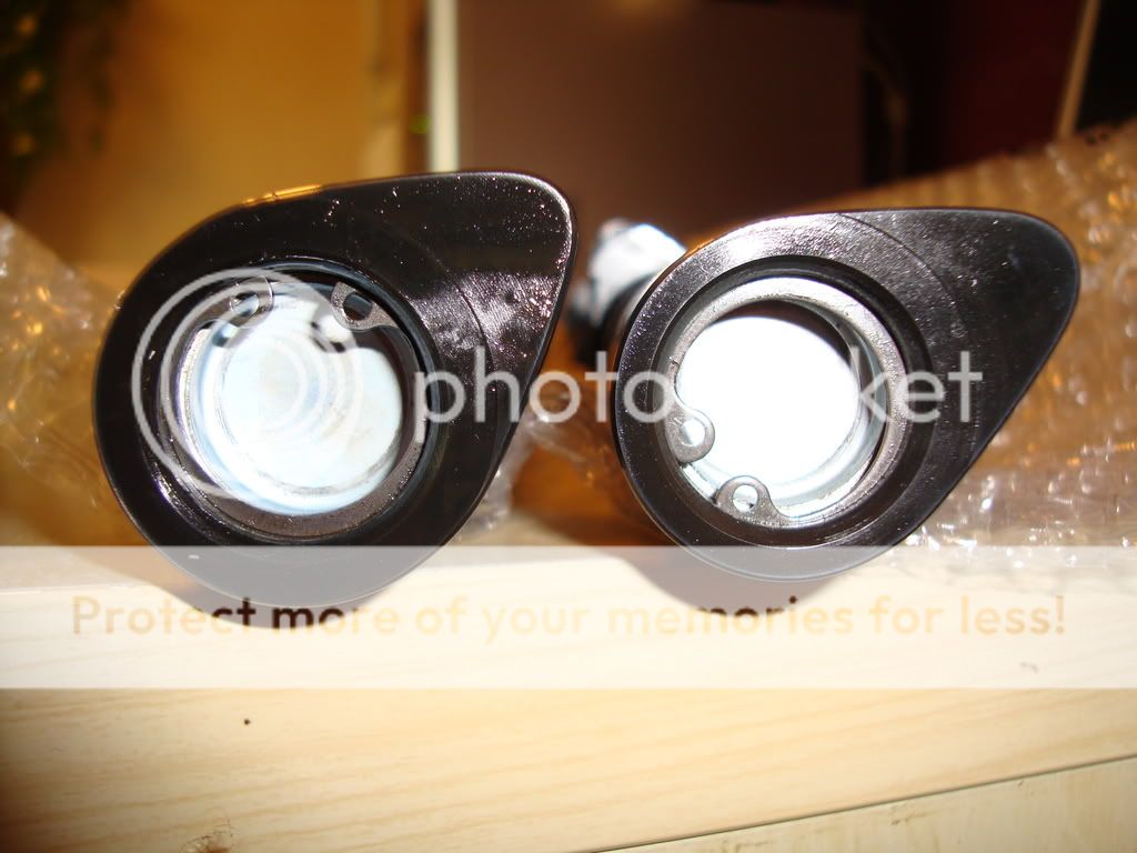

Springs and shocks spec made for racing on the Nordschleife:
Kind of proud of this one.

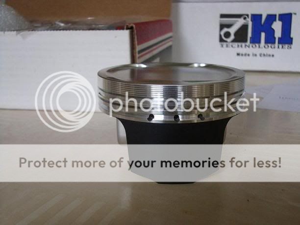

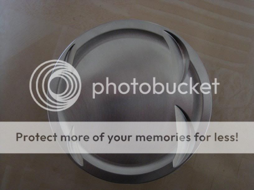

I'm still waiting for some parts like Custom wiseco pistons, K1 connecting rods, and lot of goodies for the head and things like that.

(o yea forgot to say the car has damage on the front that also needs to be fixed)
The car before i crashed it to a lantern:
And after:

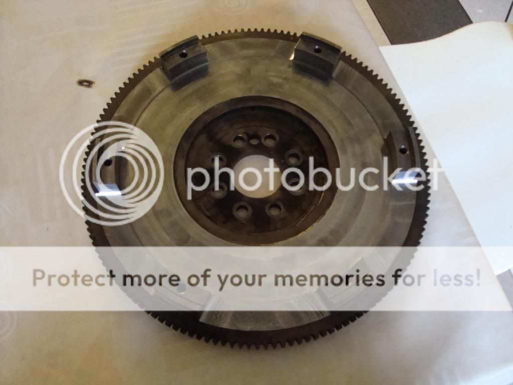

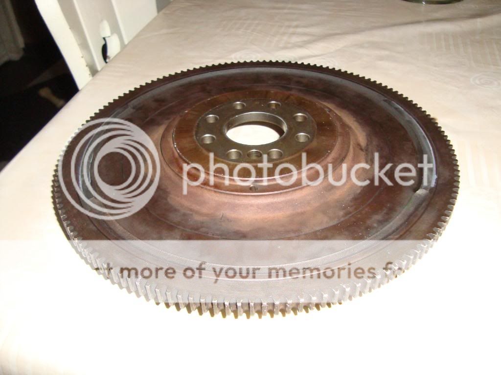

The clutch is a SPEC stage 3+ and i added an extra strong pressure plate with it.
The + means that i don't have sinterpads but a full Carbon semi-metallic friction disc and that should be easier to control/handle.
Without the stronger pressure plate it was up to about 650NM and now with the extra strong pressure plate it should handle 850NM.
Don't think i will exceed that haha
Here is there site:
http://www.specclutch.com/products
Here is there site:

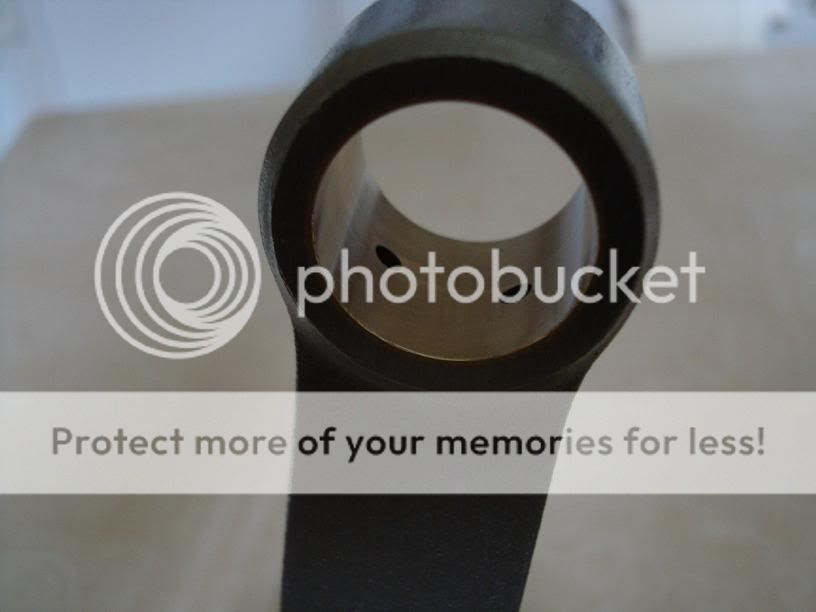

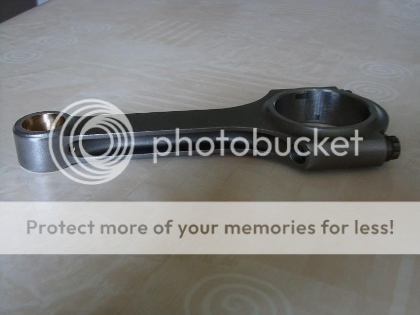

VEMS system will by put in the car by DP-engineering.
They are a dealer of VEMS and it is the same company as where i got the pistons and connecting rods from.
Btw i got 1 set of those connecting rods for sale.
The base is made in china but the drilling etc is done in the USA.
They can handle about 800hp and more then 9,000rmp was not a problem they told me.
Billet 4340 Steel H Beam connecting rods. Closely monitored material mechanical properties for optimum performance. Designed and finish honed in the USA. Sizes held to some of the tightest tolerances in the industry, +/- .0001” and +/- 1 gram per end. Shot peened for improved fatigue life. Bronze wrist pin bushings. Exclusively using ARP 2000 fasteners.
