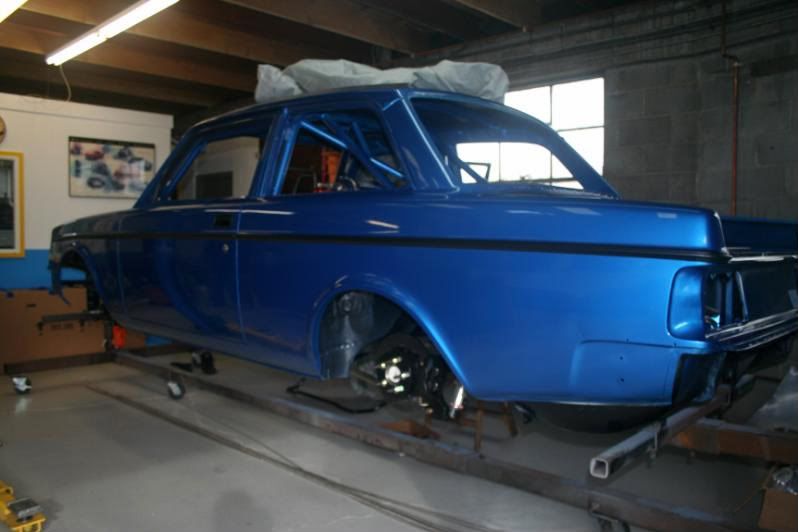

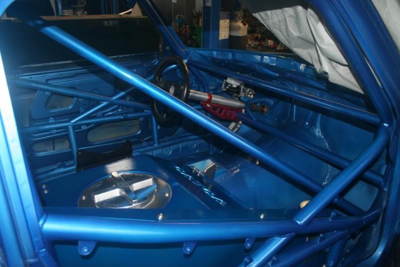

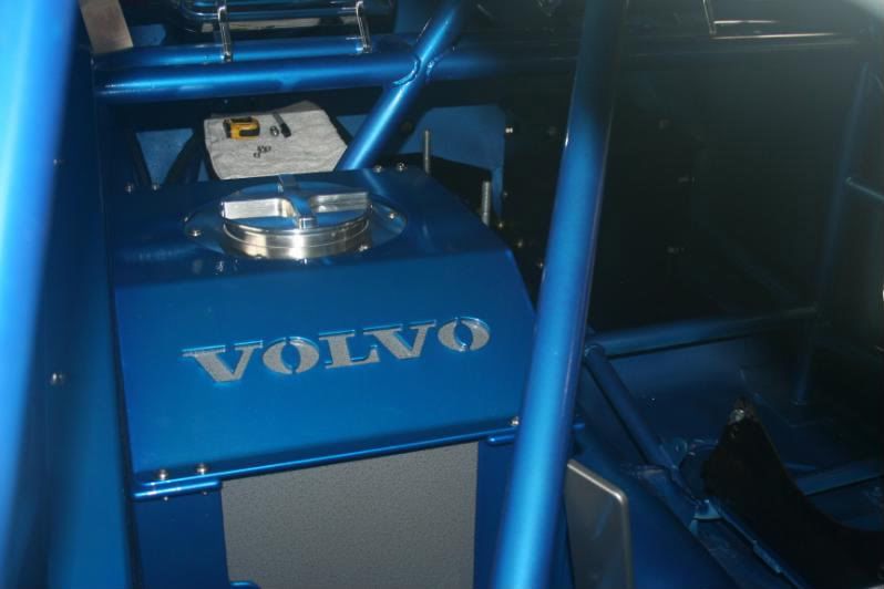

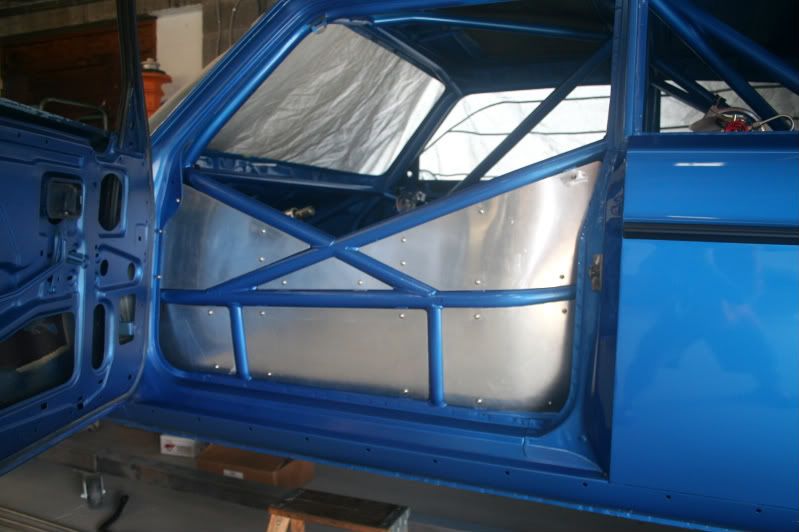

here are some pics of the car being built from the very begining.
The car started out as a very clean 1984 242GLT.

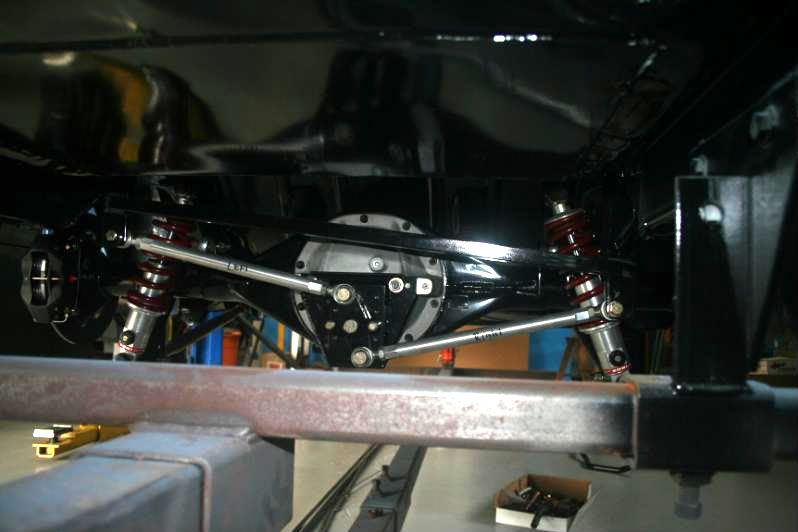

Currie Enterprises Ford 9` custom made differential with Watts Link setup.
gear ratios 2.50,3.0 and 3.25 FOR final Ratios.
Suspension.
Truechoice Race custom made coil over in front with Eibach springs
Rear: Koni coilover shocks
Taxi style front control arms w/urethane bushings
rear control arms replace with custom made Rods and spherical bearing. .

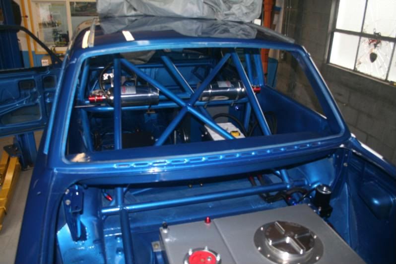

Cool project! Whats inside the blue tank on the passenger side?

LarC skrev:Cool project! Whats inside the blue tank on the passenger side?
I'd guess ice :) For the air to water intercooler.

the blue tank is for water and ice and there is also another tank like in the truck next to the fuel cell

the blue tank holds ice water for the intercooler.there is also a secondary tank in the trunk.
