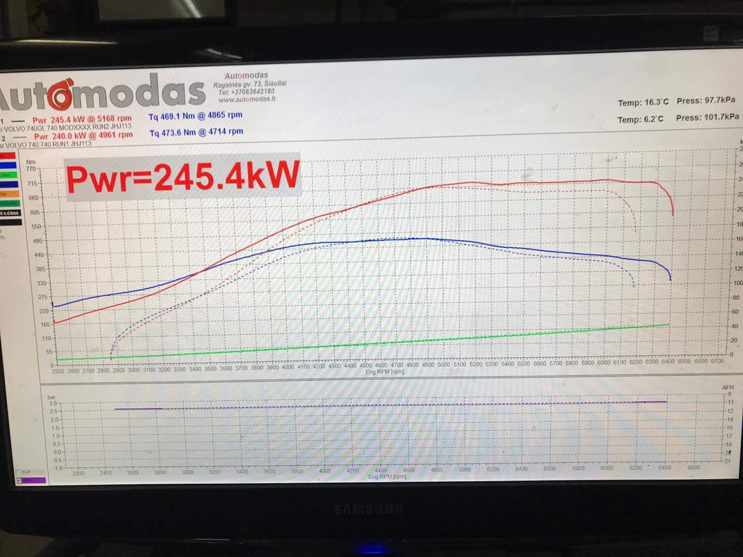

How much boost ? i had stock b230 with stock 531, A cam, split pulse mani and S200 54/58mm with 11cm housing,custom intake mani and on e85, 330hp@ 5000rpm 1.45bar ant then power curve stals to the end, feels like head dont breathe any more
1.2bar at 4000rpm, 1.45 reaches at 5000

Since there is no boost curve i had to estimate Nm/Bar/litre to 85 Nm@ 4800 rpm, this is normal if measured at wheels. (around 100Nm/Bar/litre, is normal on the flywheel)
The boost is way too low for that turbo, without more facts on the turbo whe could guess that it likes 2-2.2 Bar and the trick is to give the setup higher boost on + 5500 rpm.
If the 54/58mm is the inlet(compressor)/outlet (turbine exducer), you should see a much better result with an older turbo, there is many S-200 that have 64mm turbine exducer and they work better when you want higher boost.

im saving the stock con rods, will try to reach 2bar in higher rpm in spring, now injectors are maxed out, and maybe will try V comb and bigger valves.
9.3cr how much boost it will be safe to charge on e85 ?
