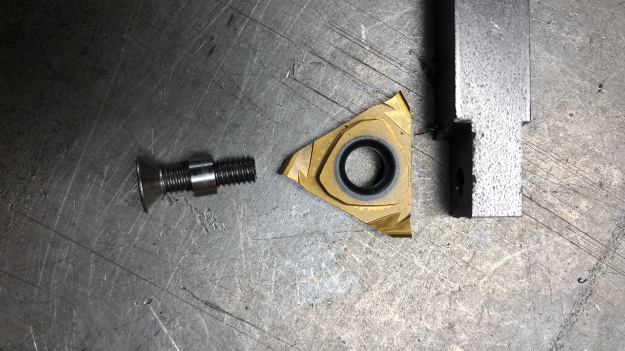

This is an old post, but i am working on something similar so wanted to share my solution.
For triple groove use
TE3.0150.07VL 1.5mm x 0.75mm Full Radius Simturn E3 Grooving Inserts (Simtek)
For single groove use
TE3.0280.14VR 2.8mm x 1.4mm Full Radius Simturn E3 Grooving Inserts (Simtek)
These are available as single inserts from Cutwel.co.uk
My thought is to use single groove as this style keeper grips the valve stem. After machining triple style grooves, the stainless steel may not be hard enough to avoid groove wear.
Available as Right Hand or Left hand
Holder is available (£70) but i made my own.
Hope this information helps in the future.

STW240 THANKS!!!
You made my day! Very useful information and thanks for sharing.
I am buying the Simtek radii tool directly from the German company.
