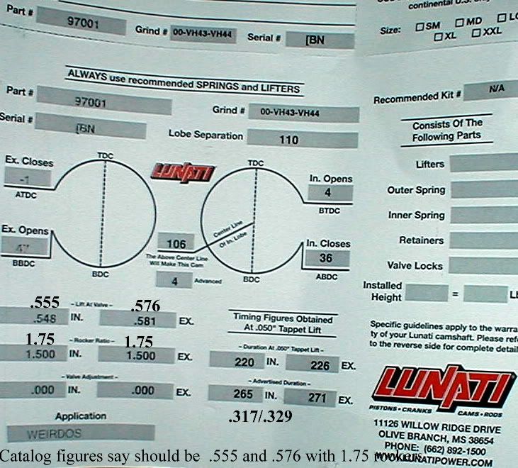

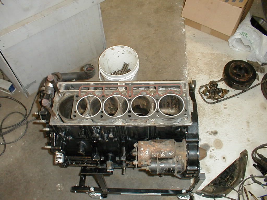

I have one I'm building with a Boss 429 head
Left to right..no trick photography- Mercruiser, B23, B20
B20 93mm bore gasket on Mercruiser deck:
My cam (pure street project) for "Schubeck" lifters 145/149 @ 1.27mm NB: Application: "Weirdos"
47 page thread on these motors
http://www.youtube.com/watch?v=2p26LxNjm10" onclick="window.open(this.href);return false;
272km sugmotor...7.78s
