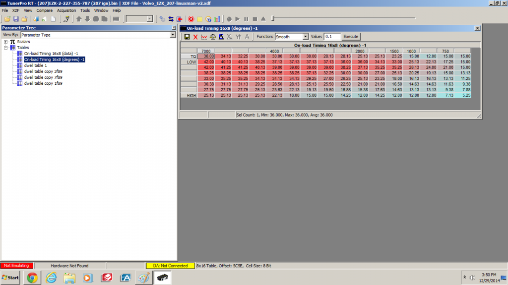

The timing map from the 148 EZK box:
It seems that it is based on load %.
