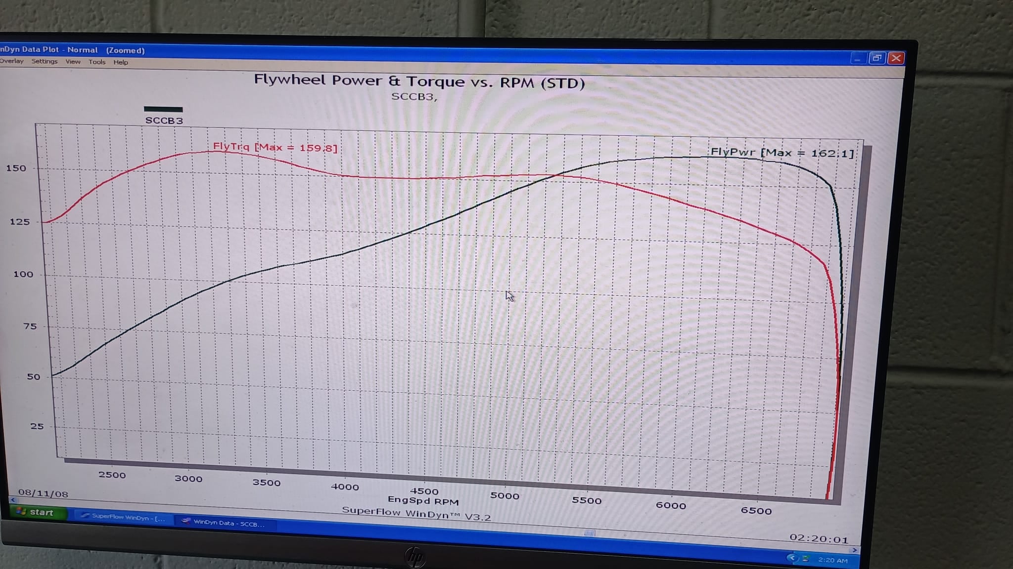

Right ok so here is the results of the engine now with a volvo H cam in it
the big dip in power mid range seems to be gone, it drives very linea. dosnt seem quick but i think it will when i get it out on a rally. i need it to pull at any revs.

You can rev it longer. If your e valvetrain is taking it 7500is no problem.
I have had engines ain the dyno that is bueprinted with racehead and so on to 8250.

yes thanks, i will take ti to 7 i think, it goes ok, its not bad at all. its linea power, it pulls at any revs, thats what i need. I have seen escorts with honda engines and its just a lot of wheel spining and not going anywhere. i think this engine has an advantage over them. the only way to find out is to do an event. thats the next plan and will report back on it
